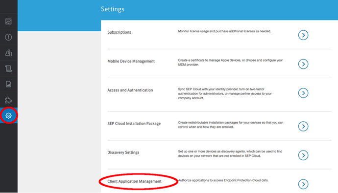

  1. Log into your SEPC account and navigate to the Settings page.
  2. Navigate to the Client Application Management page.
  3. Click on the Add Application button.

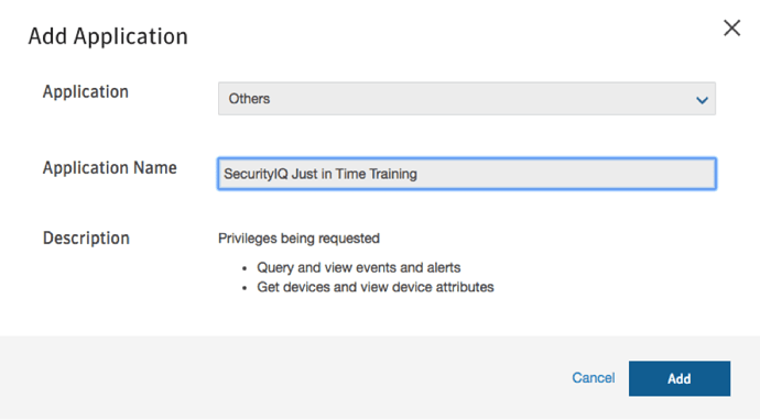

  4. Select Others and name your application. When ready, click the Add button.

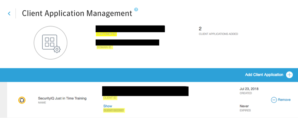

  5. Take Note of your CUSTOMER ID, DOMAIN ID, CLIENT ID and CLIENT SECRET.

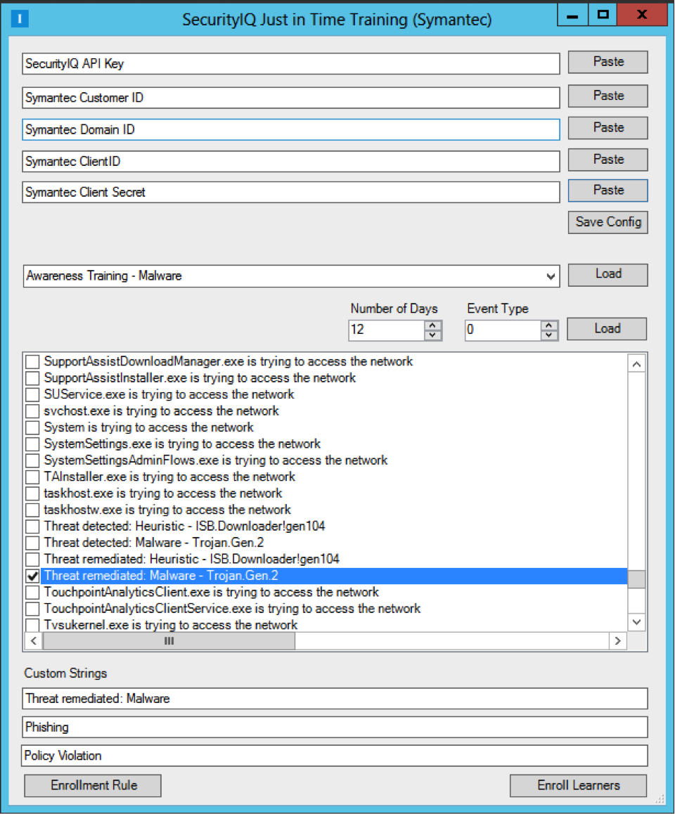

  6. Run the symantec_inegration_gui.exe file.

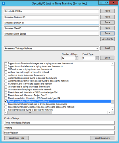

  7. Fill in the Infosec IQ API Key, Symantec Customer ID, Symantec Domain ID, Symantec ClientID and Symantec Client Secret.
  8. Click the Save Config button. This will create a config.json file in the directory where the tool is run.
  9. Select the number of days back in time that you want to load SEPC events for.
  10. Select the Event Type. Note: Event type 0 is all events. Other event types are not currently documented by Symantec, but may be in future.
  11. Click the topmost Load button. Your SIQ Awareness Campaigns will load in the dropdown.
  12. Click the next Load button. Your SEPC events that have an associated user email will load. If you there are a large number of events, this can take several minutes.
  13. Select an SIQ Awareness campaign.
  14. Select SEPC events that you want to trigger an enrollment.
Note: Due to a limitation in the SEPC API, the rule applies to the exact string you are selecting. If you want to make a more generalized rule, see the next step.
  1. To make more generalized rule, enter a custom string in the Custom String section. If an event contains your custom string, the associated learner will be enrolled in the SIQ Awareness campaign.
  2. Click the Enrollment Rule button to create an enrollment rule. A file named enrollment_rules.json will be created in the directory from which the tool is run.
  3. Repeat steps 10 through 17 for every SIQ Campaign that you want to make enrollment rules for.
  4. When ready, click the Enroll Learners button to enroll learners based on your configuration.

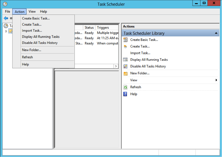

Automating the Process

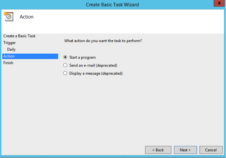

After you have completed the above steps, enrollments can be automated by using the Microsoft Task Scheduler. Simply create a task to run the symantec_integration_scheduler.exe once per day. Ensure that the config.json and enrollment_rules.json files are in the same directory as the symantec_integration_scheduler.exe file.
The symantec_integration_scheduler.exe queries events going back one day. It is important that it is run daily to avoid missing events.
  1. Open Microsoft Task Scheduler Service and select Create Basic Task.
  2. Name your task and click Next.
  3. Configure your trigger and click Next.
  4. Select “Start a program” and click Next.
  5. Browse to select the symantec_integration_scheduler.exe.
  6. Click Next.
  7. Click Finish.
